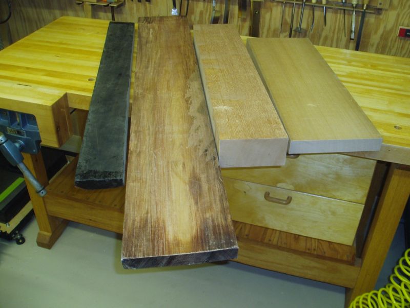

PostPosted: Sat Jul 07, 2007 7:00 am
Posts: 606
I enjoy resawing my own, some lumber yards sell redwood and clear western red cedar for decks and home interiors. If they let you pick through the boards you can find clear 1/4 sawn. For a little over a $100 I have enough for over a dozen tops and bracing. Spanish cedar, honduran mahogany, maple (curly, flame, etc.), honduras rosewood, ebony is relatively easy to find at a hardwood lumber yard in most cities. I haven't found a good source for spruce, and apparently EIR is not sold unmilled in the widths needed for backs. You'll have fun with the minimax, I have a 14se laguna, I wish I would have bought the 16" minimax. Here's some samples of Gabon ebony, Honduras rosewood, span cedar, and Western red I've found.
